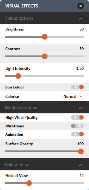

About Visual Effects
Use the Visual Effects panel to control a range of visual and lighting effects. Use together with Sun, Wind and Cloud settings to customise your model's appearance.
Click to display the Visual Effects panel.
Visual Effects Panel Experiment with these settings to see the differences each one makes
  • Brightness: Range between darkest and lightest colours in the image. High brightness reduces amount of black in colours, image looks like overexposed photograph. Low brightness increases amount of black in colours, image looks like a photograph taken with insufficient light.
  • Contrast: Lighter tones get lighter and darker tones get darker.
  • Light Intensity: Adjusts overall brightness and intensity of colours uniformly.
  • Sun Colour: Add a tint to simulation sun position.
  • Colorise: Normal, Grayscale or Sepia.
  • High Visual Quality: Rough versus high resolution rendering of image.
  • Wireframe: Reduces features to three-dimensional skeletons, displaying only lines and vertexes.
  • Animation: Turns on/off animations of water waves and clouds. Turning off THIS will cause waves and clouds to remain still.
  • Surface Opacity: Make the model surface transparent to see features below the terrain.
  • Field of View: A wide FOV zooms out from current view and flattens features, like a wide-angle lens on a camera. Features appear smaller and further away than they actually are.
