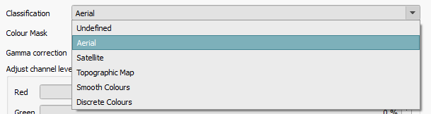

    • Classification: Specify how to classify the raster data source type. Set the correct classification to improve performance or display quality.

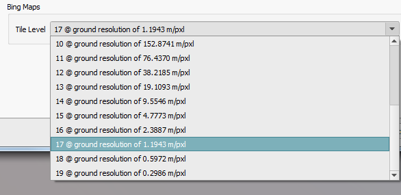

    • Bing Maps: The Tile Level option is only available for raster ground imagery data in models created using the Model Builder. By default, all Bing Maps raster ground imagery is set to Tile Level 17.
      Setting a higher Tile Level, such as Level 18 or Level 19, will provide higher resolution ground imagery if higher resolution data is available for that location. However, be forewarned, this may increase the size of the model exponentially.
