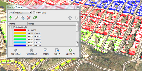

Feature Themes allow you to highlight traffic emissions along streets, show power usage of buildings, compile census data and so on.
to open the Feature Themes Palette.
(Add a New Theme).
For example, to create a theme that compares the height of buildings, select the Buildings feature class and then select the Roof Height property. The minimum and maximum values for that property are displayed. You can not change them.
If you filtered the data in your model, only the resulting feature classes for that filter are available for theming.
