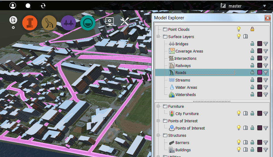

in the Utility Bar to open the Model Explorer panel.
for the feature class or subset to highlight.
By default, the Activate Highlighting icon turns a light purple colour when activated and members of that feature class or subset are highlighted that colour in the model.
The Activate Highlighting icon colour changes to the colour you specified: a dark version when highlighting is off and a bright version when highlighting is active.
