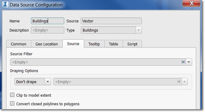

Specify draping options for imported data. Draping options determine the relationship between the imported data and the level of the terrain.
Click to open the data sources panel.
Right-click on the desired data source to configure and select Configure.
Select the Source tab.
In the Draping Options field, do the following:
If the data lies on the terrain, select Drape.
If this data lies under or above the terrain, select Set Level.
If there is a single property that represents the relationship between the data you're importing and the level of the terrain, select it from the drop-down list.
Note: To specify a data source property to represent the level, click and enter an expression.
Select Convert Closed Polylines to Polygons when importing coverage areas.
