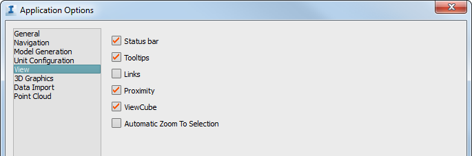

To set view options
Control visibility for tooltips, links, the status bar, the view cube and other display settings.
  1. Click .
  2. In the Application Options box, Click the View tab.
    • Toggle the Status bar on to display cursor co-ordinates in the bottom left corner of a model.
    • Toggle the display of feature Tooltips or Links. You can also toggle Proximity-based tooltip display on or off.
      See About creating Links, Tooltips and Watermarks for more information.
    • Toggle the display of the View Cube.
    • Toggle Automatic Zoom to Selection on or off to choose whether the viewport will automatically zoom to selected features.
