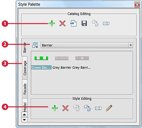

The elements in the Style Palette are:
  1. Catalogue Editing Tools — These tools affect the style catalogues, not the styles themselves. For more information, see Manage Styles and Style Catalogue.

  2. Current Style Catalogue — The dropdown list shows the current style catalogue. To change it, select a different catalogue. Click to change the size of the previews that display the contents of the catalogue. A slider lets you change the size dynamically.
  3. Category Tabs — Each tab contains catalogues of styles for a particular type of style.

  4. Style Editing Tools — These tools affect the styles within the catalogues. For more information, see Manage Styles and Style Catalogue.
    Icon Name Description
