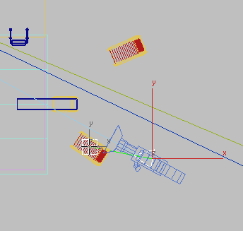

You will use the Tape helper to determine the distance between the camera and three objects in the scene: a chair, a flower pot, and a corner of the building. The location of each object will become a focal plane, or region where the scene is in the sharpest focus.
- Click on the center of the camera object and drag to the closest chair, as shown in the next illustration.
On the Parameters rollout, the Length field displays the distance between the two objects as roughly 2.3 meters.
- Press Delete to delete the Tape helper.
- Click on the camera again, then drag to the flower pot across the pool.
The Length field displays a length of about 20 meters.
- Click on the camera, then drag to the lower-left corner of the villa.
The Length field displays a length of about 28 meters.
- Press Delete to delete the Tape helper, and then right-click to exit Helper creation mode.
