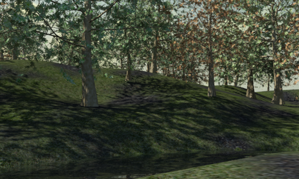

In this tutorial, you will learn how to use mr Proxy objects to create a scene of a forest that, despite its large size, can render quickly.
You will convert trees to mr Proxy format, then give each proxy a material you saved in a material library. Finally, you will use the Object Paint feature to instance the proxies multiple times and distribute them across the scene.
