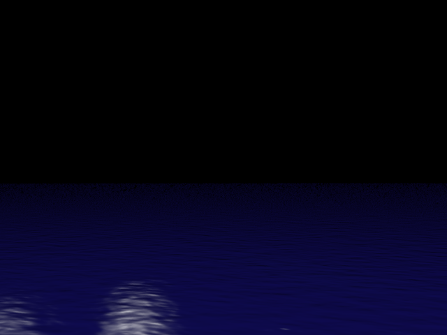

    First, you will change the sea to a more realistic color.

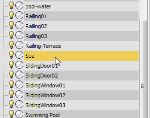

  1. On the Scene Explorer panel, click the the Sea object to highlight it.
  2. Activate the Camera-Terrace viewport, then on the main toolbar, click (Rendered Frame Window) to display the rendered frame.

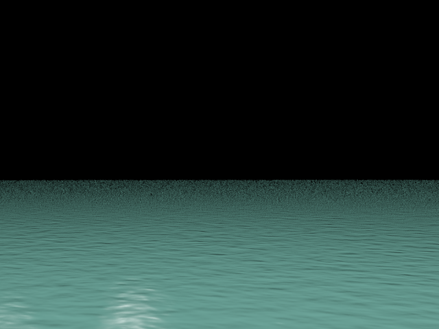

  3. On the Rendered Frame window Area To Render drop-down list choose Selected, then click the Render button.
    This rendering takes some time, so feel free to cancel the rendering once you get an idea of the result.
    The color of the sea water is suitable for a day scene but not for nighttime.
  4. Open the Slate Material Editor.
  5. In the Material/Map Browser, scroll to the Scene Materials group, and locate the the Water - Sea entry. Drag this entry into the active View, and when 3ds Max asks whether to use an instance or a copy, make sure Instance is chosen, then click OK.
  6. Double-click the Water - Sea material node so you can see its parameters in the Parameter Editor panel at the right.
  7. On the Water rollout, open the Color drop down list, and choose Custom.
  8. Click the Custom Color swatch and on the Color Selector that opens, pick a deep blue color: Red=0.005, Green=0.025, Blue=0.1.
  9. Render the sea again. Again, you can cancel the rendering once you get an idea of the result.
  10. On the Area To Render drop-down list, choose View so that the next time you render, the entire scene will be included.
  11. Minimize the Rendered Frame Window.

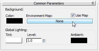

  1. Open the Rendering menu and choose Environment to open the Environment And Effects dialog. On the Common Parameters rollout, click the Environment Map button (at present, the text on the button says (“None”).
    3ds Max opens the Material/Map Browser.

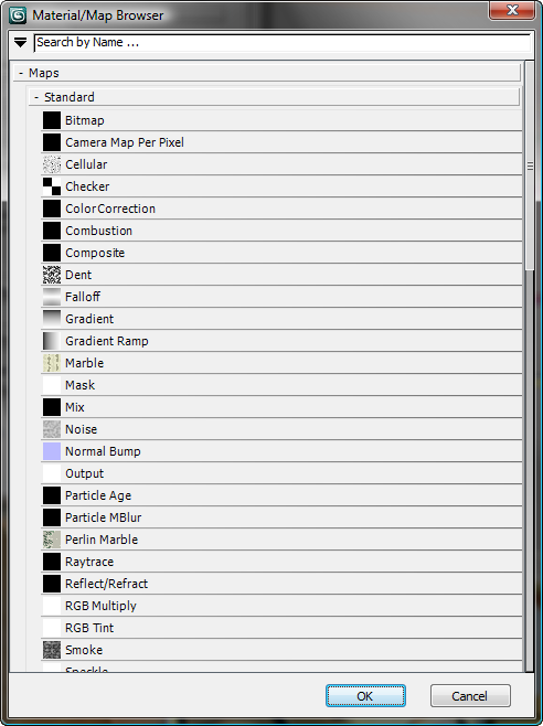

  2. On the Material/Map Browser, double-click the Bitmap map type. (Bitmap is in the Maps Standard group.)
    3ds Max opens a file dialog.

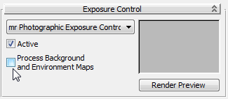

  4. On the Exposure Control rollout make sure Process Background And Environment Maps is off.
    When this option is turned on, 3ds Max applies the exposure control to the background map itself. For most bitmaps (those that don’t save a high dynamic range), in effect this makes the background and other environment maps invisible.

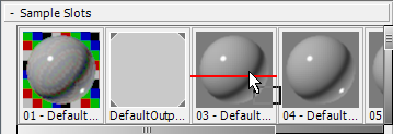

  7. Drag the Environment Map button from the Environment And Effects dialog and drop it onto an unused sample slot. The sample slot shows a red bar across it when you are able to drop the map.
    3ds Max asks if this should be an instance or a copy. Make sure Instance is chosen, and then click OK.

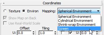

  13. On the Coordinates rollout, open the Mapping drop-down list and choose Screen.
    The default mapping for an environment map is Spherical Environment, but we want the desert image to display like a backdrop.

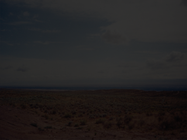

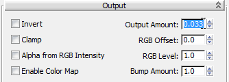

  1. On the Output rollout, decrease the Output Amount to 0.033.
  2. Click an empty area of the Camera-Terrace viewport to deselect all objects.
  3. Right-click and from the quad menu, choose Hide Unselected.
  4. Render the Camera01 viewport.
    The result is a heavily underexposed image, resembling a night sky: a digital version of filming “day for night.”
