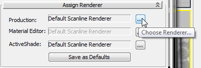

  2. On the Render Setup dialog Common tab, scroll down to the Assign Renderer rollout. Open the rollout if it isn't already open.

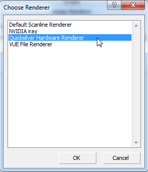

  3. On the Assign Renderer rollout, click the (Choose Renderer) button to the right of the Production label.
    The Production renderer is the one used to render finished output.
    3ds Max opens the Choose Renderer dialog.
  4. On the Choose Renderer dialog, click to select Quicksilver Hardware Renderer from the list, and then click OK.
  5. On the Render Setup dialog, click Render.

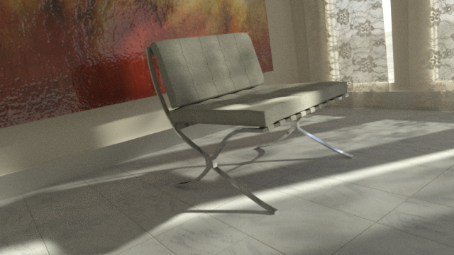

    3ds Max uses the Quicksilver renderer to render the scene.

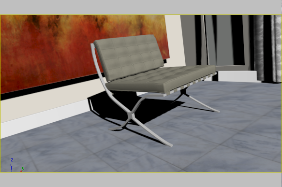

    The Quicksilver renderer uses your system's CPU to prepare scene data for rendering. It uses the graphics card (Graphics Processing Unit, or GPU) to perform the actual rendering. The first time you render a scene, the CPU needs to compile the shaders used in the rendering. This can take some time, but it needs to happen only once per shader: Subsequent renderings are faster than the first rendering. For example, on one system this scene initially takes over 30 seconds to render, but subsequent renderings take only 5 seconds or less.
    The Quicksilver hardware renderer supports a limited set of materials and maps or shaders. For details, see Quicksilver Hardware Renderer.
    To render scenes quickly, the Quicksilver renderer simplifies shadows and some other scene details. This will be apparent when you compare the Quicksilver rendering with an iray rendering of the same scene, later in this lesson.

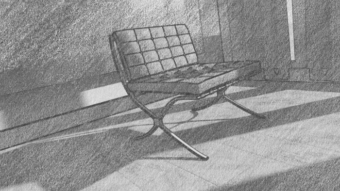

Try one of the Quicksilver renderer's non-photorealistic styles:

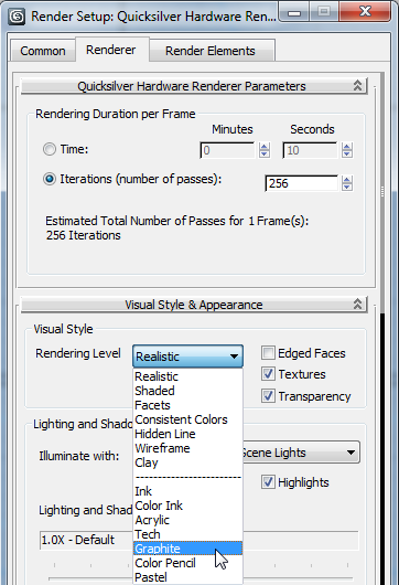

  1. On the Render Setup dialog, go to the Renderer tab.
  2. In the Visual Style & Appearance rollout Visual Style group, click to open the Rendering Level drop-down list, then click to choose Graphite from that list.
  3. On the Render Setup dialog, click Render once again.
    3ds Max renders the scene again, this time in the style of a pencil sketch.
    You might want to experiment by rendering the chair using other non-photorealistic styles.

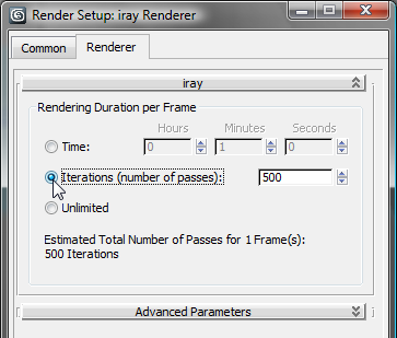

  4. On the Render Setup dialog, go to the Renderer tab. On the iray rollout, choose Iterations (Number Of Passes).
    The main iray renderer controls simply set the duration of rendering: You can choose to set the time in hours, minutes, and seconds; to specify the number of iterations; or to set an Unlimited rendering. The Unlimited option is good for overnight rendering.
    If you leave the value of Iterations set to its default of 500, rendering this scene takes about 5 1/2 minutes, as tested on a dual-processor 64-bit system running at 2.6GHz, with graphics-card acceleration. If your rendering is taking longer than you want it to, you can cancel it and then reduce the number of iterations.

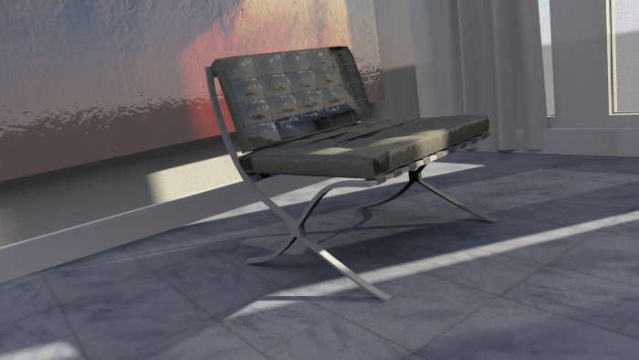

    3ds Max uses the iray renderer to render the scene.

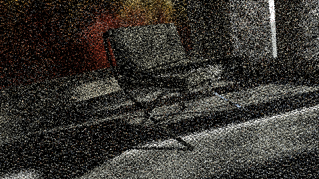

    The first iteration is dark and grainy.
    Each iteration adds detail and reduces the graininess. After several iterations, the scene begins to become clear.
    Here is the result after the full 500 passes:
    Compared to the Quicksilver rendering in Realistic mode, the lighting and shadows are much subtler, and the curtains and their shadows show fine details that were not apparent before. Lighting and reflections on the painting are subtler, too.
    There is still some graininess in the darker shadows: An Unlimited rendering would correct that.
