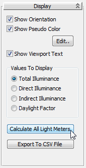

  2. Go to the Modify panel Display rollout and click Calculate All Light Meters.
    A progress bar appears in the status-bar area of the 3ds Max window. After a few moments, the viewports update to display the readings calculated by each sample point, based on the lighting data you defined for the CIE sky model.

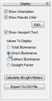

  4. Go to the Modify panel and in the Display rollout Values To Display group, choose Direct Illuminance.
    The sample points all return a value of 0 because, being an overcast day, there is no direct sunlight to record.

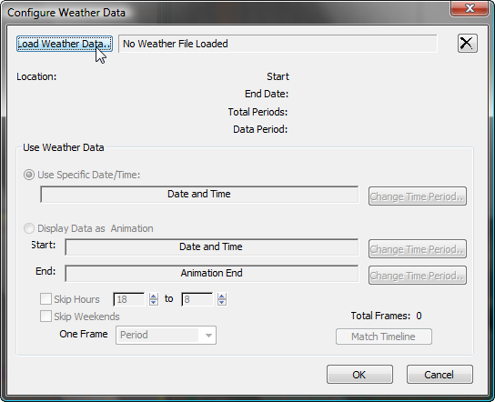

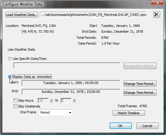

  6. In the Modify panel Daylight Parameters rollout Position group, choose Weather Data File, then click Setup.
  7. On the Configure Weather Data dialog, click Load Weather Data.
  8. On the Open Weather File dialog, choose the weather file you just saved from the Web, then click Open.

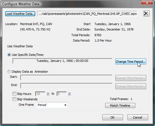

  9. In the Configure Weather Data dialog Use Weather Data group, click Change Time Period.
    By default, the weather data is set to January 1st, 1966, at noon, but you will choose a summer date.

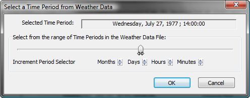

  10. On the Select A Time Period From Weather Data dialog, drag the Time Period slider until the Selected Time Period box displays Wednesday, July 27, 1977; 14:00:00.
    Use the Increment Period Selector controls to narrow down the selection if you need to. Click OK.
    Tip: If you wish to use a date that is unavailable from the weather data files, you can contact the U.S. Department of Energy via its Web site.
  11. On the Configure Weather Data dialog, click OK to add the weather data to the scene.

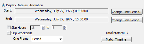

  1. With the Daylight sun object selected, go to the Modify panel and in the Daylight Parameters rollout Position group, click Setup.
  2. In the Use Weather Data group, choose Display Data As Animation.
  3. For the Start value, click Change Time Period and in the Select A Time Period From Weather Data dialog, use the slider and spinner controls to set the date and time to Wednesday, July 27, 1977; 9:00:00, then click OK.
  4. Repeat the previous step for the End value and set the time to 15:00:00.
    The Use Weather Data group indicates a total of seven frames created as a result of the selection range.
  5. Click Match Timeline, then click OK.
    The timeline updates to show seven frames.

  8. Drag the time slider to the last frame in the sequence, frame 7, then in any viewport, select the Light Meter object.
  9. On the Modify panel Display rollout, make sure Total Illuminance is chosen, and then click Calculate All Light Meters.

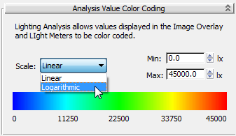

Adjust lighting analysis color feedback:
  1. From the main menu, choose Lighting Analysis Lighting Analysis Assistant, and go to the General panel.
    The Analysis Value Color Coding rollout displays a color ramp. The ramp intensity range is currently set between 0.0 and 10000.0 units. The units are in lux (lx), the international unit of measure. If you prefer, you can switch to the United States unit of measure, foot-candles (fc) on the Units Setup dialog.
    Given that the scene illumination is over 42,000 lux in places, the color range is currently too narrow. You need to widen the color ramp range.
  2. Change the value of the Max spinner to 45000.0, and press Enter.
    In the viewport, the color range now shows light intensity much more effectively.
    Light meter readings showing improved color coded feedback
    The orange areas of the tennis court interior show direct sunlight for this time of day, while the blue areas show indirect sunlight.
  3. From the Scale drop-down list, choose Logarithmic.
    The color-coded areas update to provide a different visualization of the light intensity, but the intensity values themselves remain unchanged.
  4. From the Scale list, choose Linear again.
