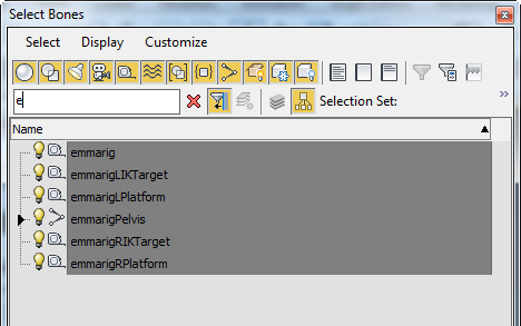

    This opens the Select Bones dialog, which is the same as the familiar Select From Scene dialog.
  3. Highlight all list entries except the hair, hat, and eyes. The easiest way to do this, because all the desired bones start with “Emma,” is simply to type e in the Find field. Click Select to finish.
    The bones appear in the list on the Parameters rollout and the basic skinning is done. You can demonstrate this by moving the leg via the foot platform.
