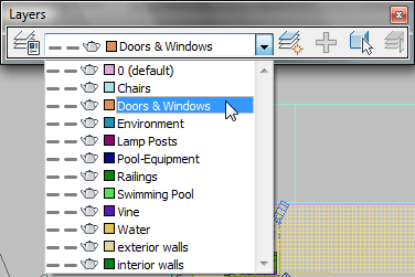

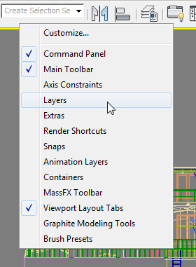

  1. On an empty area of the main toolbar, right-click and choose Layers from the pop-up menu.
    3ds Max opens the Layers toolbar.
  2. Choose Doors & Windows from the drop-down list of layers.
  3. Click (Select Objects In Current Layer) to select the doors and windows.
  4. Right-click any viewport and on the quad menu, choose Isolate Selection to display only the selected objects.

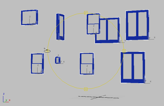

Add the Sky Portals:

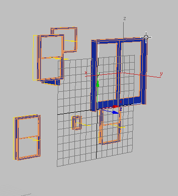

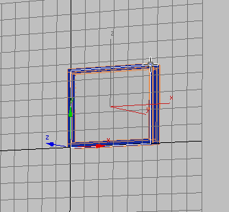

  1. On the Create panel, click (Lights). On the Object Type rollout, click “mr Sky Portal” to activate it, then turn on AutoGrid.
  2. In the Perspective view, create the first Sky Portal by dragging diagonally from the lower-left corner of any window to the upper-right corner, until the entire opening is covered.
    Tip: When you create a Sky Portal, make sure that the Z axis of the AutoGrid grid is perpendicular to the glass pane of the window or door, as shown in the illustration.
  3. Repeat the previous step for every door and window object in the scene, except for the PivotDoor02 object (it is second from the right in the upper-right corner of the viewport).

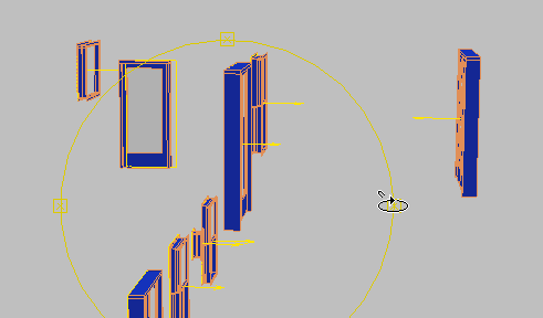

  4. Orbit the Perspective view so that the windows and doors are visible from their sides, as shown in the next illustration.
    The yellow arrow for each SkyPortal object indicates the direction of the light flow, or flux. Because you used AutoGrid to place the SkyPortal object on the exterior face of the doors and windows, the light flux arrows point in the proper direction, into the building. (If you created the Sky Portal from the inside of the building, you would have to reverse the light flux either by rotating the window/door, or turning on Flip Light Flux Direction on the “mr Skylight Portal Parameters” rollout.)

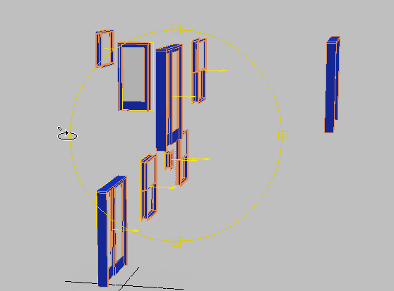

  5. Orbit the scene again until the PivotDoor02 object is facing you. Create another Sky Portal object by dragging across this door.
  6. Orbit the scene one last time so that the sides of the doors and windows are visible, as shown in the next illustration. The PivotDoor02 object should have its light flux direction pointed in the correct direction: into the room from the opposite side of the building.

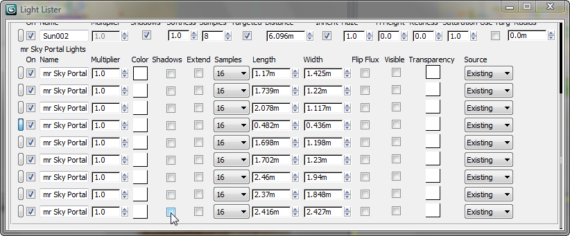

    You do not need interior shadows for an exterior shot when viewed from a distance. Also, turning off Shadows helps to reduce render time. If you had created a single Sky Portal, you could turn off the Shadows toggle here; but since you’ve created several Sky Portal objects, it is easier to use the Light Lister.
  3. From the main menu choose Tools Light Lister. In the Light Lister dialog Shadows column, turn off Shadows for each mr Sky Portal object in the scene.
  4. Close the Light Lister.

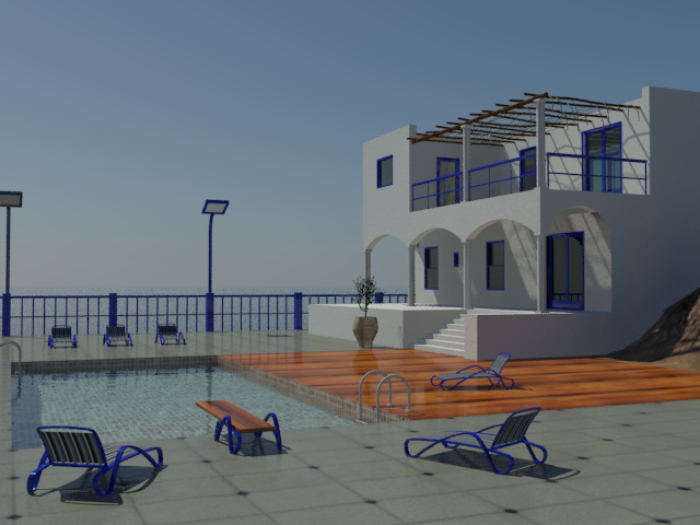

Render the terrace to see the effect of the Sky Portals:
  1. Render the Camera-Terrace viewport and compare the result with the rendered frame you cloned earlier in this lesson.
    The result is subtle, but improved. The window and door openings are slightly lighter because now the Sky Portals are channeling sky light into the villa.

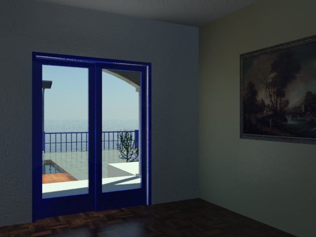

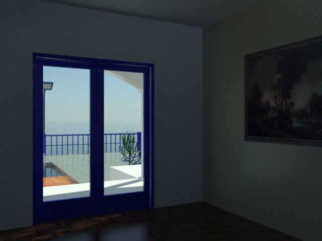

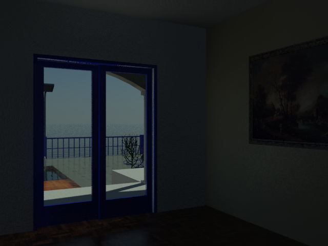

  1. Switch the Camera-Terrace viewport to a Camera-Interior view, then render the scene.
    Because scene exposure is set to outdoor conditions, the outside portion of the scene is properly exposed, but the interior is too dark. You need to adjust the exposure setting to compensate for the lower light of the building interior.

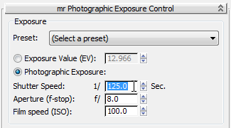

  2. On the Rendered Frame Window, click (Environment And Effects Dialog (Exposure Controls)) to display the Environment And Effects dialog.
  3. On the mr Photographic Exposure Control rollout Exposure group, make sure Photographic Exposure is chosen, then set Shutter Speed to 125.0 (1/125 Sec.).
    Keep the Environment And Effects dialog open for now.

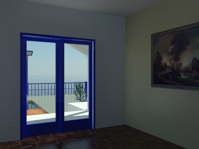

  4. Make a clone of the rendered frame, then click Render to render the scene again.
    The slower shutter speed is now permitting more light to enter the camera, resulting in a better inside exposure.

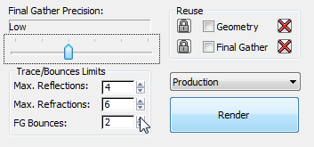

    You can further improve the interior lighting by increasing the number of bounces to each ray of light entering the interior.
  5. Clone the current rendered frame. In the Rendered Frame window mental ray controls, change the Final Gather Precision to Low, and increase the value of FG Bounces to 2.
  6. Render the interior view again and compare the result with the cloned frame.
  7. Close the earlier cloned frames, then make a new clone of the most recent rendering.
    If you wish, you can take things further by dragging the Final Gather Precision and Image Precision slider bars to the right. Keep in mind that the greater the precision, the slower the rendering time.
