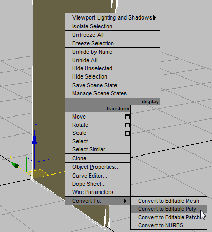

  1. Make sure the box is selected, right-click it, and from the Transform (lower-right) quadrant of the quad menu choose Convert To Convert To Editable Poly.
    The ribbon updates to display a range of polygon-editing tools.

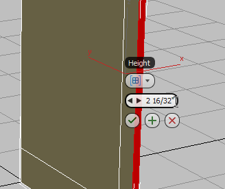

  8. On the ribbon Polygons panel, Shift+click (Extrude).
    (When you Shift+click one of these tools, 3ds Max displays the caddy controls for that tool.)
  9. On the second control of the Extrude caddy, Height, set the value to 2.5, then click (OK).

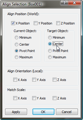

  1. Go to the Hierarchy panel, and in the Adjust Pivot rollout Move/Rotate/Scale group, click Affect Pivot Only to turn it on.
  2. On the main toolbar, click (Align), then in the viewport, click the cabinet.
  3. In the Align Selection dialog Align Position (World) group, make sure X Position is on and Y Position and Z Position are off. In the Current Object group, choose Pivot Point and in the Target Object group, choose Center, then click OK.
  4. Click Affect Pivot Only again to exit pivot-translation mode.

  4. On the main toolbar, click (Align), then in the viewport, click the cabinet.
  5. In the Align Selection dialog Align Position (World) group, turn on X Position, Y Position, and Z Position. In the Current Object and Target Object groups, choose Center, then click OK.

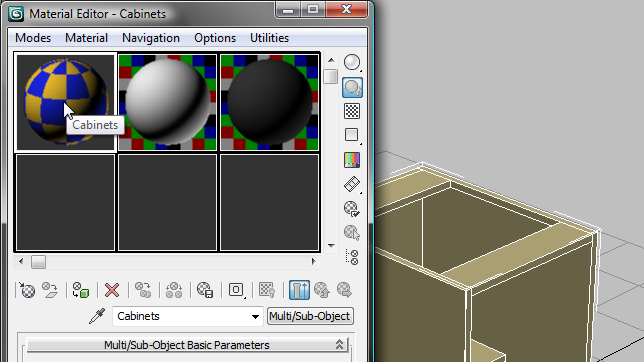

  1. On the main toolbar, click (Material Editor) to open the Compact Material Editor.
    Note: There are two versions of the Material Editor: the Compact interface, and the Slate interface. The Slate version is more versatile when you are designing materials, while the Compact version is a bit more convenient when you just need to assign existing materials.
  2. Click the top-left sample slot to make it active. The material in this slot is named Cabinets.
  3. In the Material Editor, click (Assign Material To Selection).
  4. Close the Compact Material Editor.
