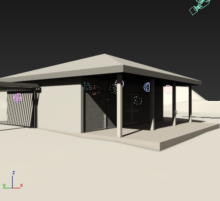

  1. In the Perspective viewport, click the Point-Of-View (POV) viewport label (at first, it’s labeled “Perspective”), and choose Cameras Views: Exterior.
    The viewport switches to the viewpoint of the camera you set up in Revit.
    The house has light objects, as you can see on the porch and in the carport, but they are turned off because you specified a sun-only export format.

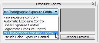

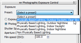

  2. On the Rendered Frame Window, click (Environment And Effects Dialog (Exposure Controls)) to open the Environment And Effects dialog. Here, you will set the proper exposure for the scene.
  3. On the Exposure Control rollout, if “mr Photographic Exposure Control” is not already active, choose it from the drop-down list.
  4. On the “mr Photographic Exposure Control” rollout, scroll down so you can see the Gamma / LUT Settings group at the bottom of the rollout. If gamma is disabled, click Setup. If gamma is already enabled, skip ahead to step 7.
  5. 3ds Max opens the Preferences dialog to the Gamma And LUT tab. Turn on Enable Gamma/LUT correction. Make sure that Gamma is chosen, and that the gamma value is set to 2.2.
    Turn on both options in the Materials and Colors group as well: Affect Color Selectors and Affect Material Editor.
    Adding gamma correction improves the appearance of renderings.
  6. Click OK to close the Preferences dialog.

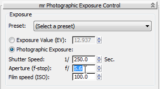

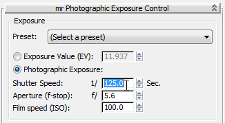

  7. On the "mr Photographic Exposure Control" rollout, choose Photographic Exposure.
  8. Also in the “mr Photographic Exposure Control” rollout Exposure group, choose Physically Based Lighting Outdoor Daylight, Clear Sky from the Preset drop-down list.
  9. Set the value of Shutter Speed to 250.0 (1/250 Sec.) and the value of Aperture (f-Stop) to 5.6.
    These settings correspond to those you would use with a film camera in comparable lighting conditions.

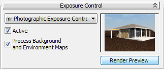

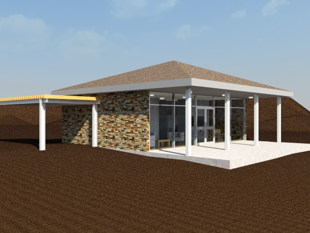

  10. On the Exposure Control rollout, make sure Active is turned on, then click the Render Preview button to quickly check how your exposure preset will affect the scene.
  11. The result seems fine, so in the Rendered Frame window, click Render.
    The house looks good but the terrain appears too regular because it was not optimized in Revit. In the procedures that follow, you will replace the terrain material with a material you create in 3ds Max.

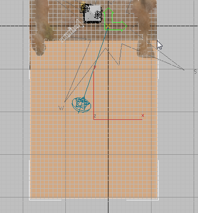

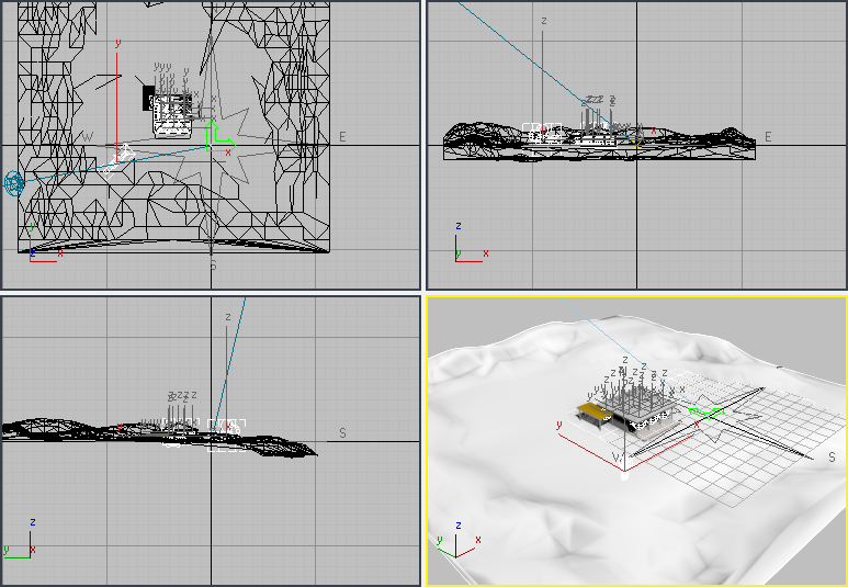

  1. Switch to a four-viewport layout, activate the Top viewport, and select the object that represents the terrain.
  2. The terrain object is named Unknown, so go to the Modify panel and in the Name field, change the name to Terrain.
    As the Modify panel shows, from the 3ds Max point of view the Terrain object is simply a linked object from another file.
    For the terrain to show a mapped texture in viewports, it needs a UVW Map modifier.
  3. Also on the Modify panel, open the Modifier List and apply a UVW Map modifier to the Terrain object.
  4. In the UVW Map modifier Parameters rollout Mapping group, leave the projection type set to Planar, and if Real-World Map Size is turned on, turn it off.

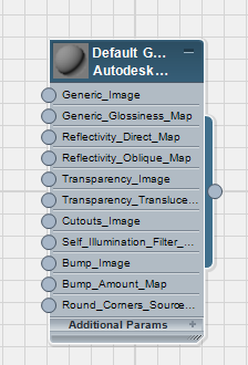

  2. Drag an Autodesk Generic material from the Material/Map Browser panel at the left, into the active View in the center of the Slate Material Editor. (Autodesk Generic is in the Materials mental ray group.)
    3ds Max displays a node for the Generic material in the active View.
  3. Double-click the new Generic material node.
    The parameters for the Generic material appear in the Parameter Editor panel at the right of the Slate Material Editor.
  4. Change the name of the material to Terrain.
    As you update the name in the Name field, the name in the title bar of the material node also updates.

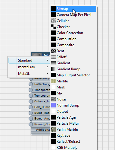

  5. In the active View, drag a wire away from the Generic_Image component of the Terrain material node.
    Release the mouse. 3ds Max opens a pop-up menu.
    On the pop-up menu, choose Standard Bitmap.
    3ds Max opens a file dialog.

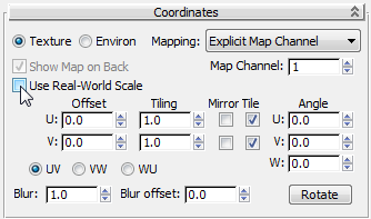

  8. On the Coordinates rollout, if Use Real-World Scale is on, turn it off.
    You need to turn off Use Real-World Scale so you can fit the map to the surface object on a one-to-one ratio. For the same reason, leave the Tiling values set to their default values of 1.0 in U and 1.0 in V.

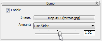

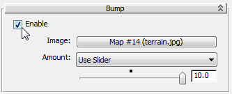

Add bump mapping to the terrain:
  1. Press M to restore the Slate Material Editor window.

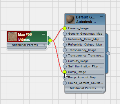

  2. In the active View, drag a wire from the output socket of the Bitmap node (the circular control at the right of the node), and connect the wire to the Bump_Image component of the Terrain material node.
  3. Double-click the Terrain material node so you can see its parameters. Scroll down to the Bump rollout, and click to turn on Enable.
  4. Drag the Amount slider so the bump Amount has a value close to 1.0.
    The bump mapping doesn’t appear in viewports, but it will be apparent when you render the scene.

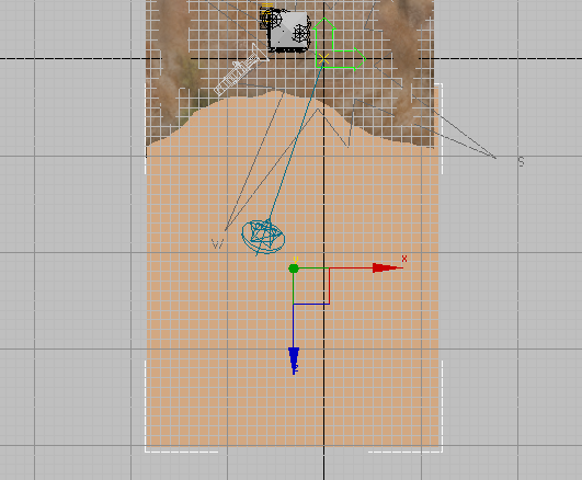

Create a surface that will become the ocean:
  1. In the Top viewport, zoom out and pan so the terrain area is smaller, and the house is at the top of the viewport.
  2. Go to the Create panel, activate (Geometry), and on the Object Type rollout, click to activate Plane.
  3. In the Top viewport, drag to create a plane that overlaps the lower portion of the Terrain object.
  4. Press G to turn off the grid display in the Top viewport.
  5. On the main toolbar, click (Select And Move) to make it active. Activate the Front viewport. In the Front viewport, move the plane vertically while you watch the Top viewport. Stop moving the plane when it intersects the Terrain object in a way that suggests a shoreline.
    Next, you will change the plane's rendering scale so that in renderings it will extend to the horizon.
  6. Go to the Modify panel. Change the name of the plane object to Ocean.
  7. In the Parameters rollout Render Multipliers group Scale field, type 50.
    This multiplies the surface of the plane by a factor of 50 each time the scene is rendered. Using the Scale factor can be more convenient than giving the plane huge dimensions.

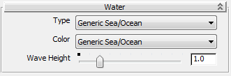

  2. Drag an Autodesk Water material from the Browser into the active View. (Like the Autodesk Generic material, Autodesk Water is in the Materials mental ray group.)
  3. Double-click the Water material node so you can see its parameters.
  4. On the Water rollout, set Type to Generic Sea/Ocean and Color to Generic Sea/Ocean.
  5. Move the Slate Material Editor window so you can see both the active View and the Top viewport. Drag from the output socket of the Water material node and drop the material onto the Ocean plane you just created.
    Now you have a water surface for the ocean in your scene. Before you can see the ocean in a rendering, however, you need a new point of view.

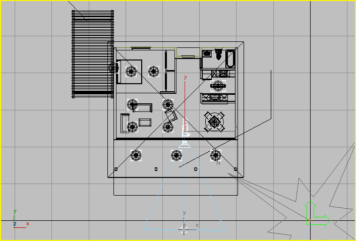

Add another camera:

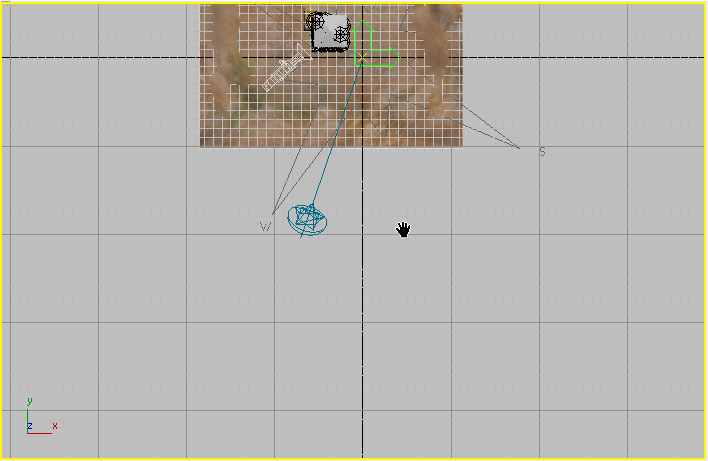

  1. Activate the Top viewport, and press F3 to turn off shading.
  2. Use (Pan) and (Zoom Region) to get a close-up view of the bungalow.

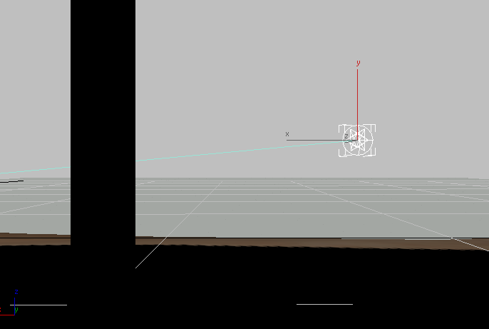

  3. Go to the Create panel, activate (Cameras), and on the Object type rollout, click to activate Target.
  4. Click to place the camera on the terrace just in front of the double doors, then drag downward to point its target in the direction of the ocean.
    The camera is created at ground level. Now you will raise the camera object to eye level.

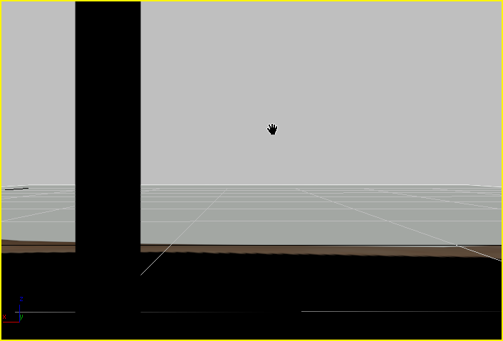

  5. Activate the existing camera viewport, 3D View: Exterior, and press C to display the viewport from the perspective of the newly created camera.
  6. Go to the Modify panel Clipping Planes group, and make sure that Clip Manually is turned off.
  7. Click (Pan) and drag downward, causing the camera and its target (the horizon) to rise from ground level simultaneously.
    Tip: It helps to watch other viewports while you adjust the camera position. It can also help to temporarily switch the Camera001 viewport to a wireframe view.
  8. Drag the Pan tool to the right slightly until you have a column in the foreground.

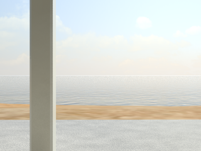

  9. Render the scene.
    From the porch, you can see the beach and the ocean.

  3. Close the Environment And Effects Dialog.
  4. In the 3D View: Exterior viewport, dolly back until you can see all of the carport.
  5. On the Rendered Frame Window, click Render to render the new exterior view.
    The result is similar to your earlier rendering. In the next lesson, you will change the size of the carport.
