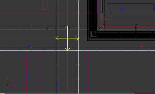

  3. In the Top viewport, click just in front of the building whose wireframe color is blue, then drag upward, press Shift, and click again near the top of the walkway to create another straight flow that intersects the first one. Right-click to end flow creation.
    A second flow for the crosswalk and walkway intersects the first.
    Notice how Populate displays four-way arrows where the flows cross each other.
    It is important to make sure these arrows appear: If you don't see them, it means the flows did not intersect correctly. When the intersection is incorrect, pedestrians on one flow might walk through pedestrians on the other!
    The angle between intersecting flows can be between 45 and 135 degrees. Pedestrians that encounter the intersection sometimes change direction and turn left or right instead of continuing ahead.

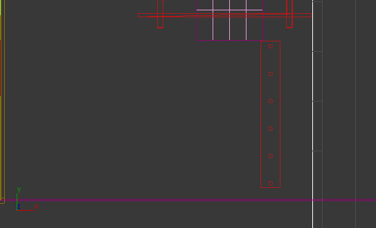

  2. On the Populate tab Define Idle Areas panel, click (Create Rectangle Idle Area) to activate it.
  3. In the Top viewport, zoom out a bit, then drag to specify a rectangular idle area at the end of the walkway, apart from the pedestrian flows (and not overlapping the people on the bench).
    Within the viewport display of the idle area, the circles show conversations between two or three characters. Characters not on the edge of a circle are solitary.
    The Idle Area rollout has even more adjustments than the Flow rollout, but the default values are fine for this simulation.
  4. Right-click to end Idle Area creation.

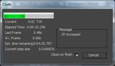

(Optional) Increase the length of the flag animation:
    You might notice a glitch in using Populate Simulate to extend the animation length: The flags above the walkway cease to move at the original animation length of 300 frames. You can correct this as follows:
  1. Select flag01.
  2. in the Modify panel Object rollout Simulation group, click Simulate.
    3ds Max displays a progress dialog while it extends the Cloth simulation.
  3. Repeat these steps for flag02.
    The motion of the flags still winds down, as the only force acting on them is gravity. But the motion does continue beyond frame 300.
