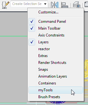

- With the helper still selected, click the ListCon button on the myTools toolbar you created earlier in this tutorial.
The ListCon script automatically assigns the two Position list and Rotation list controllers you set up earlier, permitting you to retain control over the helper’s local orientation.
If the myTools toolbar is not currently displayed, right-click a blank area of the main toolbar and choose myTools from the menu.

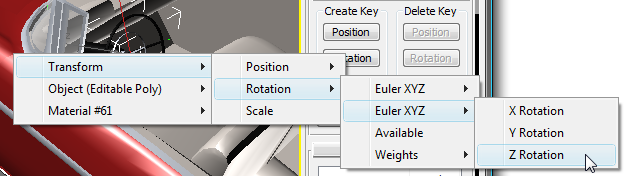

- In the Camera viewport, select the steering wheel (SWheel).
- Right-click the steering wheel and choose Wire Parameters.
- From the menu, choose Transform
Rotation
(2nd) Euler XYZ
Z Rotation.

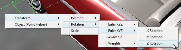

- Click the Dummy-FL object, which is the front left wheel helper, and choose Transform
Rotation
(2nd) Euler XYZ
Z Rotation.

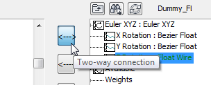

- On the Parameter Wiring dialog, set the control direction to both ways, since the manual turning of either object affects the other.
- Click Connect, and leave the Parameter Wiring dialog open.

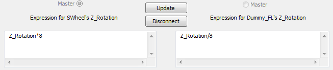

Notice how the steering wheel and the front wheel turn in the opposite direction. You will correct this by modifying the controller expression. A second adjustment is also required. The front wheel needs to turn far less than the steering wheel. This is because the pivot range of a front wheel is about 90 degrees, whereas a steering wheel's range of movement is two to three complete revolutions.
Steering wheel and front wheel turn in opposite directions
- Cancel or
undo the rotation you made in the previous step.
- In the left-hand Expressions panel, under “Expression for SWheel’s Z_Rotation”, type: –Z_Rotation*8.
- In the right panel, under “Expression for Dummy_FL’s Z_Rotation”, type: –Z_Rotation/8.
The minus sign (-) operator ensures that the two rotations are aligned, and the *8 and /8 factors ensure that the front left wheel pivots (rotates in Z) eight times less than the rotation of the steering wheel.
- Click Update and test your work by rotating the steering wheel on its local Z axis again.
Notice the more realistic behavior.

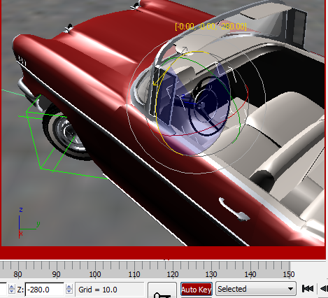

- Turn on
and rotate the steering wheel until the Z axis status bar reads –280.
Steering wheel rotation at –280 degrees about the Z axis

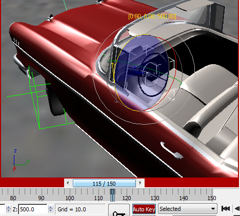

- Go to frame 115, the point where the car is in the middle of the second turn, and rotate the steering wheel until the Z axis status bar reads 500.
Steering wheel rotation at 500 degrees in the Z axis
