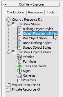

On the Civil View Explorer, click to display the Resources tab.
In the Resources tab hierarchy, click to highlight Object Placement Styles.

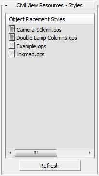

3ds Max opens an Explorer rollout that shows the saved OPS styles.

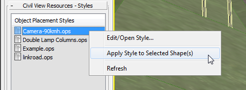

On the Civil View Resources - Styles rollout Object Placement Styles list, right-click the Camera-90kmh.ops entry, and from the pop-up menu choose Apply Style To Selected Shape(s).
3ds Max adds an animated camera to the scene. If you drag the time slider, you can see the camera object moving along the roadway.

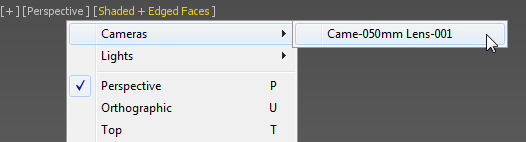

Click or right-click the POV viewport label (it currently reads "[ Perspective ]"), and from the menu choose Cameras Came-050mm Lens-001.
Now the viewport shows the camera's point of view.
