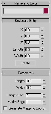

The Name and Color rollout lets you rename objects and change their wireframe color.
Sets the patch center.
Sets the patch length.
Sets the patch width.
Creates a patch based on the XYZ, Length, and Width values.
Sets the grid dimensions in current units.
Determines the number of facets along the length and width of the grid. Default=1.
The density of a Quad Patch rises sharply as you increase the segments. A Quad Patch of two segments on a side contains 288 faces. The maximum is 100 segments. High segment values can slow performance.
Creates map coordinates for applying mapped materials. Default=off.
