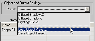

Object and Output Settings group
- Preset drop-down list
- Lets you save presets comprising all current Render To Texture settings, including map types and sizes, from a single object and then load a preset onto any number of objects. Render To Texture presets use the RTP filename extension. Presets contain all settings on the Objects to Bake and Output rollouts and the Projection Options dialog. The only exceptions are the Object Level and Sub-Object Levels radio buttons in the Objects To Bake rollout
Projection Mapping group and the Use Automatic Unwrap
Channel numeric values in the Objects To Bake rollout
Mapping Coordinates group. Use the upper part of the list to choose an existing preset to load. The preset is applied to all objects in the objects list. The list contains up to the last 10 maps in the order that they were loaded or saved, with the most recent at the top.
After you choose a preset to load, a dialog appears showing you the path and name of the file containing the preset. Confirm or deny loading the preset by clicking Continue or Cancel, respectively.
In addition, if Projection Mapping is enabled, the dialog might contain related messages. For example, if the target object needs a Projection modifier, the dialog suggests that you use the Pick function to add one.
