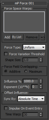

Interface
Because the mParticles Force operator is designed for simulation usage, it has a few more options than the standard Force operator.
- Force Space Warps
- Lists space warps currently in the simulation.
To add a space warp to the simulation, click Add and then select the space warp, or, to add several at one time, use By List. To remove a space warp, highlight its name in the list and click Remove.
- To select a space warp assigned in mParticles Force, highlight it in the list and then click this button. This selects the space warp in the scene and makes it easy to access the space warp parameters.
- Force Type

- Force Variation Threshold
- When on, the force applied to a particle is calculated as a cumulative force applied to all vertices of a particle shape. Thus, a non-uniform force can create a torque moment.

- Shape Size
- The minimum particle size upon which a force applied is calculated as a cumulative force applied to all vertices of a particle shape. With this option you can speed up calculations by specifying that force for sufficiently small particles can be calculated as applied to a particle point. Available only when Force Variation Threshold is on.
- Force Field Overlapping
- Determines how multiple forces that occupy the same volume of space affect the particles. With Additive, the forces are combined according to their relative strengths. With Maximum, only the force with the greatest strength affects the particles.
- Influence %
- Specifies the strength with which the force or forces are applied to the particles as a percentage. Default=1000.0.
- Exponent (10**N)
- This setting can be useful when dealing with different force types. The overall effect of a force applied can be affected by particle mass/size, so you might need to apply large force values when dealing with small particles. To simplify the process, you don't need to increase the Influence % value by an order of magnitude; instead, you can just increase Exponent spinner by 1.
- Offset Influence
- Choose the time frame for applying animated parameters. This works the same way as in the standard Force operator. The options are:
- Absolute Time Any keys set for parameters are applied at the actual frames for which they're set.
- Particle Age Any keys set for parameters are applied at the corresponding frames of each particle's existence.
- Event Duration Any keys set for parameters are applied to each particle starting when it first enters the event.
- Impulse On Event Entry
- Applies the force only once, when a particle enters the event. The value of the force applied is calculated as if the force is applied constantly for the period of time specified by the Time Warp value.

- Time Warp
- The duration over which the force is calculated when Impulse On Event Entry is on; this derived force is then applied instantaneously to each particle as it enters the event.
