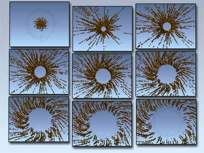

The Motor space warp works like Push, but applies rotational torque to the affected particles or objects rather than a directional force. Both the position and orientation of the Motor icon affect particles, which swirl around the Motor icon.
Motor disperses a cloud of particles
Motor viewport icon (with particle system on the left)
