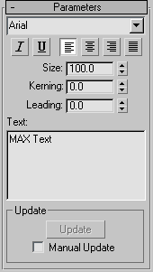

Parameters rollout
Once you have created text, you can make changes using the following parameters:
Font list
Choose from a list of all available fonts. Available fonts include:
Italic style button
Toggles italicized text.
Underline style button
Toggles underlined text.
Align Left
Aligns text to the left side of its bounding box.
Center
Aligns text to the center of its bounding box.
Align Right
Aligns text to the right side of its bounding box.
Justify
Spaces all lines of text to fill the extents of the bounding box.
Note: The four text-alignment buttons require multiple lines of text for effect because they act on the text in relation to its bounding box. If there's only one line of text, it's the same size as its bounding box.
Size
Sets the text height where the height measuring method is defined by the active font. The first time you enter text, the default size is 100 units.
Kerning
Adjusts the kerning (the distance between letters).
Leading
Adjusts the leading (the distance between lines). This has an effect only when multiple lines of text are included in the shape.
Text edit box
Allows for multiple lines of text. Press Enter after each line of text to start the next line. Note the following:
  • The initial session default is "MAX Text."
  • The edit box does not support word wrap.
  • You can copy and paste single- and multi-line text from the Clipboard.
Update group
These options let you select a manual update option for situations where the complexity of the text shape is too high for automatic updates.
Update
Updates the text in the viewport to match the current settings in the edit box. This button is available only when Manual Update is on.
Manual Update
When on, the text that you type into the edit box is not shown in the viewport until you click the Update button.
