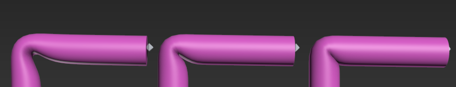

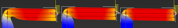

- Falloff (Both solvers)
- Determines how smoothly the joints blend. Lower values cause a more gradual falloff, while higher values create more-abrupt transitions.
Left: Falloff=0.0; Center: Falloff=0.3; Right: Falloff=1.0
Same Falloff values as in the preceding illustration, with visualization of vertex weighting
