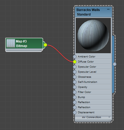

  4. Drag a material of the type you want from the Material/Map Browser panel to the active View.
    3ds Max displays the material as a node in the active View.
    Example of a material node

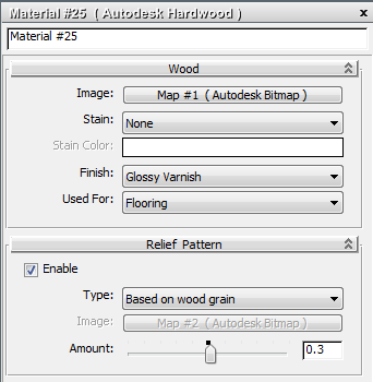

  5. Double-click the material node to display its parameters in the Parameter Editor panel.
  6. Use the Parameter Editor to enter settings for the various material components: diffuse color, glossiness, opacity, and so on.
    Material parameters in the Parameter Editor
    (Double-click a node to display the node’s parameters)
  7. Assign maps to the components you want to map, and adjust the map parameters.
    You assign a map to a material by “wiring” the map and material nodes together.
