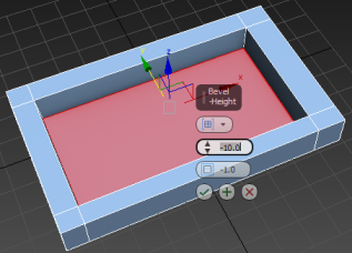

  6. Go to the Polygon sub-object level, select the inside polygon on the top of the box, and extrude it inward about 10 units. Exit Extrude mode.

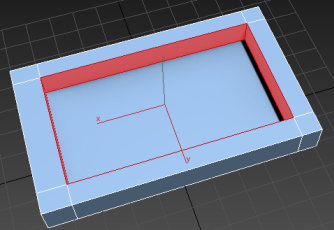

  7. Still at the Polygon level, select the four vertical inside polygons. Then go to the Edge sub-object level and select the four inner edges at the top of the box.

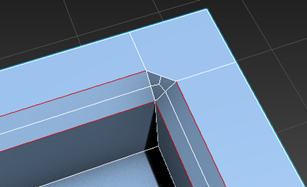

  2. Access the Edge sub-object level, if it's not already active, and apply the Chamfer modifier from the Modifier List on the Modify panel. Zoom in on a corner to get a better look at the results.
    As you can see, the four edges have been chamfered, and the new polygons at the corners are all quadrilateral. This output is the result of the default Operation setting: Quad Chamfer.

  5. Set Operation back to Quad Chamfer, then drag the Tension spinner slowly downward to 0.0 while keeping an eye on the chamfered corner.
    The lower the Tension setting, the more the chamfered area bulges outward, until it's a sharp corner at 0.0. If you're going for a more rounded chamfer, it's better to use a higher Tension value.
  6. Set Tension to 0.7 and increase Segments to 3.
    This produces a nicely rounded chamfer, with a smooth transition between the adjacent surfaces.
