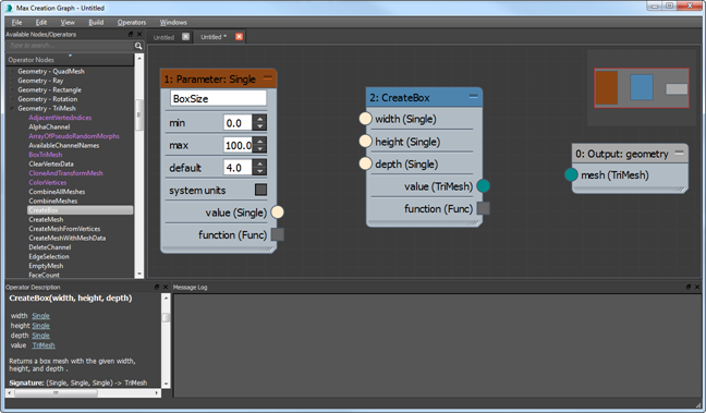

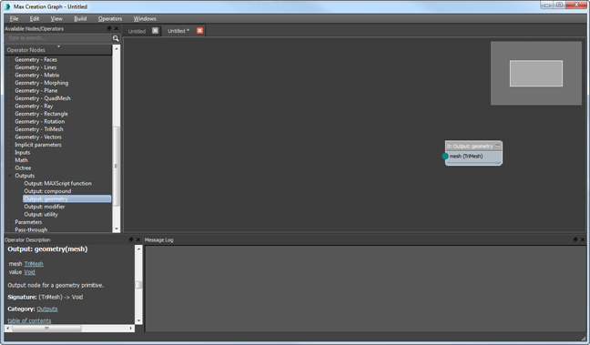

  1. Open the graph editor: On the menu bar, click the Scripting menu to open it, then choose Open Max Creation Graph. (If using the enhanced menus, it's on the Script menu.)
    You'll start your graph at the end, with the node that generates the geometry the graph defines.
  2. In the Available Nodes/Operators list on the left side of the editor window, scroll to the Outputs category, expand it, and drag an Output: geometry node into the graph window, near the right side.
    This node will generate the result of the remainder of the graph. Graphs typically flow from left to right.
    Next you'll add the first node in the graph.
  3. Expand the Parameters category in the Available Nodes/Operators list and drag a Parameter: Single node into the graph window, near the left side. Double-click the text field (currently reads "name"), edit the text to read BoxSize, and press Enter.
    Parameters appear in the interface of the graph output (in this case, with the label BoxSize), and enable users of your graph to enter values in the interface. The Parameter: Single node lets the user specify a single-precision floating-point number; that is, a decimal fraction. As the designer of the graph, you can also limit user input to a specific range of values, and specify a default value.
    You could keep the default value of 0.0, but it would make more sense to use a starting size that produces a visible object.
  4. In the "default" field, enter 4.0. Keep the default "min" and "max" values of 0.0 and 100.0.
    You now have the start and the end of the graph, representing input and output, respectively. All that remains is to add a processing node, and to wire the nodes together to form a graph.
  5. Expand the Geometry - Trimesh category and drag a CreateBox node into the view. Place it between the two existing nodes.
    The CreateBox node takes three floating-point values as inputs, and outputs a box-shaped TriMesh (triangle-based mesh) object. Thus it has three beige-colored input connectors on its left side, for the three dimensions of the box, and a single teal-colored output connector on the right side. Note that the color of the Parameter: Single node's output connector matches that of the CreateBox's input connectors, indicating that the connectors use the same type of data. Likewise for the CreateBox's output connector and the Output: Geometry node's input connector.

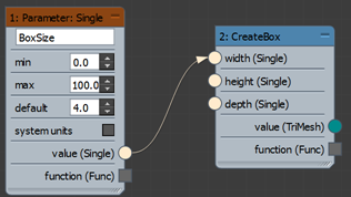

  6. Drag between the Parameter: Single node's output connector, value (Single), and the width (Single) input connector of the CreateBox node. The direction you drag doesn't matter.
    The result is a wire from the first node to the second. The wire uses the same color as the connectors it's wired between, and the arrow on the wire indicates the data flow direction.
  7. Similarly, wire the Parameter: Single value (Single) connector to the height (Single) and depth (Single) input connectors of the CreateBox node.
    The result is three wires going from the Parameter: Single node's single output to each of the CreateBox node's three inputs. This means that the one value from the Parameter: Single node will be used for all three of the box's dimensions, thus producing a cube. If you wanted to use different values, you could just add two Parameter: Single nodes and wire them separately to the CreateBox node's inputs.

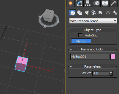

  11. When you evaluate a geometry graph successfully, its output appears by default in the Max Creation Graph category of the Create panel. Go to the Create panel, open the drop-down list and choose Max Creation Graph. Then, on the Object Type rollout, click the MyBox button.
    The Parameters rollout appears on the Create panel, with a single BoxSize parameter. Its default value is 4.0, which will produce a small box.
    1. Click in a viewport to add a box, then adjust the BoxSize parameter value to change the box's size.
      Congratulations: You've just created your first MCG graph!

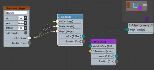

    One way to reposition the box is with an offset-type node.
  2. In the Operator Nodes list to the left side of the editor window, expand the Geometry: Trimesh category, if necessary, and drag the OffsetMesh node into the graph. Position it between the CreateBox and Output: Geometry nodes.
    You'll use this node to reposition the mesh on the Z (vertical) axis.
    Tip: A Compound is a special type of node that contains an MCG graph. It's denoted by purple coloring in the Operator Nodes list as well as in the Compound node's header. To see a Compound node's makeup, right-click the node in the graph or Operator Nodes list and choose Open Compound In New Tab.
    Compounds can even be nested. The OffsetMesh graph contains another Compound: DeformMeshPoints.

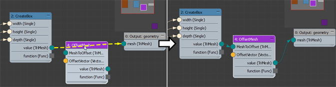

    At this point, you could wire the OffsetMesh node to the CreateBox and Output: Geometry nodes in two different actions, but instead you'll use a shortcut.
  3. Press and hold Ctrl, then drag the OffsetMesh node to the wire between CreateBox node's output and the Output: Geometry node's input. When the wire changes to a dashed yellow line, drop the node and release Ctrl.
    MCG automatically inserts the new node between the two existing ones, using the correct TriMesh connector types on both sides.

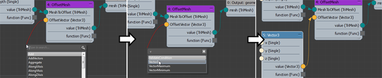

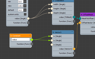

    The other OffsetMesh node input (orange connector) is OffsetVector, which lets you specify the object offset in three dimensions, and thus requires a Vector3 input type. In the next step, you'll use a convenient feature to add the requisite node without having to find it in the Operator Nodes list.
  4. Drag from the orange OffsetVector connector on the left side of the OffsetMesh node to an empty spot in the graph editor, and release the mouse button.
    A small search list opens next to the mouse cursor, with a list of nodes that have output connectors compatible with the Vector3 input connector type. Most of these have output types Any, which is compatible with most other types. In this case, we'll use a connector directly compatible with the Vector3 input.
  5. On the keyboard, type V (the case doesn't matter).
    MCG narrows down the available choices to nodes that start with "V".
  6. In the list, click the Vector3 node.
    The new Vector3 node appears in the graph, wired to the OffsetMesh node's OffsetVector connector.

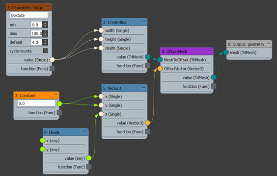

    Next you'll provide value inputs for the Vector3 node. You'll be offsetting only the Z-axis position, so you can simply set X and Y to 0.

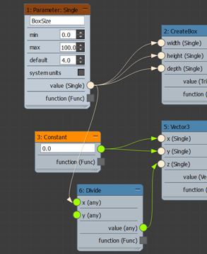

  7. In the Operator Nodes list, expand the Constants category and drag a Constant node into the graph, to the left of the Vector3 node. Wire its Value output connector to both the X and Y inputs of the Vector3 node.
    Note: A Constant node, like a Parameter node, provides a value input to the graph. The difference is that with a Constant node, the value setting isn't readily available to the user of the graph; only to its author.
    Also, the Constant node's output connector is green, indicating that it is of type Any. This means that it can output any type of numeric value (integer, float, and so on) and is compatible with all input connectors that require numeric values.
  8. Set the Value field of the Constant node to 0.0.
    Important: Entering the value as a decimal fraction tells MCG that this number is to be treated as a float, not an integer, as it would be if you simply specified 0.

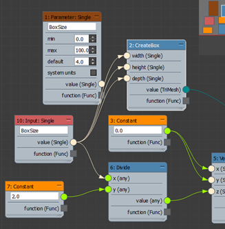

    Next you'll use a simple calculation to specify the Z value. By default, the box is positioned halfway down into the home grid, so you want to raise it by half its height. You'll calculate the offset with division, using an arithmetical node.
  9. Use any method you've learned to add the Divide node to the graph (it's in the Math category). Position it to the left of the Vector3 node and wire its Value output to the Z input of the Vector3 node.
    Divide has two inputs of type Any: X is the numerator and Y is the denominator. In other words, the output of Divide is the X input divided by the Y input. You already have the numerator: BoxSize.
  10. Wire the Value output of the BoxSize Parameter node to the X input of Divide.
    You'll need another Constant node for the denominator. You can create this by cloning the existing Constant node.
  11. Shift+drag the Constant node downward a bit, which makes a duplicate of the node. Drop the copy near the Divide node, change its value to 2.0, and wire its output to the Y input connector of Divide.
    At this point, your graph might be a bit messy; this is easy to fix.

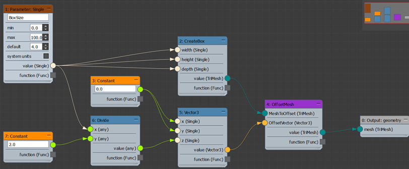

  12. Right-click in the graph window and choose Lay Out All.
    This straightens up all the nodes.
  13. Save the graph and evaluate it.
    This replaces the MyBox tool on the Object Type rollout of the Max Creation Graph category.
  14. Use the MyBox tool again to create a new box.
    Now when you adjust the BoxSize value, the bottom of the box stays on the grid.

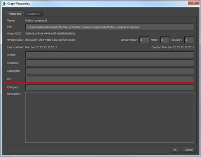

    1. In the Max Creation Graph dialog, open the Edit menu and choose Edit Graph Properties.
      The Graph Properties opens, with various fields you can use to describe the graph. The one you'll use in the next step is the Category field, outlined in the following illustration.
      Note: Most of these settings simply help to keep track of various aspects of your graph, but the Category field has an actual, functional effect.
  4. In the Category field, enter the name of the category from the Operator Nodes list that the compound should appear in. For this example, enter Geometry - TriMesh.
    Tip: You can specify any category you like, including a new one. If you don't specify a category, the compound appears in the Compounds category.

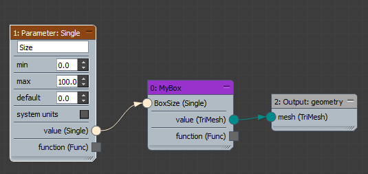

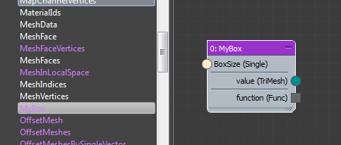

  7. Near the top of the editor dialog, right-click next to the MyBox.maxcompound tab and choose Create New View.
    A new, empty tab labeled "Untitled" opens.
  8. Expand the Geometry - TriMesh category and drag the MyBox compound node into the empty view.
    The input connector uses the BoxSize label you entered in the Input: Single node.
  9. From the Parameters category, drag a Parameter: Single node to the left side of the graph. From the Outputs category, drag an Output: Geometry node to the right side of the graph.
  10. Change the text field in the Parameter: Single node to Size, and wire the two nodes to the input and output connectors of the MyBox compound.
  11. Save the new graph in the Tools\ folder as SimpleBox and then evaluate it.
