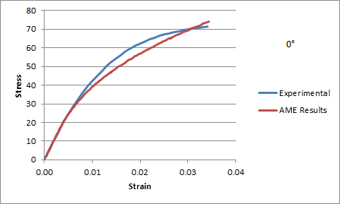

  5. Plot the stress-strain curve and compare with the experimental stress-strain data for the Extron 3019 HS material at 0 degrees.
We can see a very good agreement between the experimental data at zero degrees and the outputs from Advanced Material Exchange. Keep in mind, Advanced Material Exchange uses a stress-based failure criterion, so the fact that we get a very similar ultimate stress for each curve gives us confidence that the tool can be used reliably going forward.

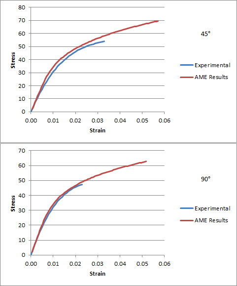

45 and 90 Degree Curves

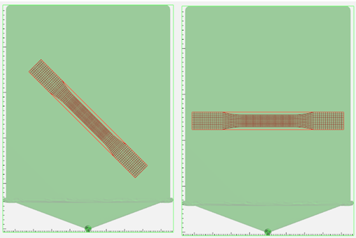

We can now repeat the Advanced Material Exchange steps outlined in this tutorial, rotating the coupon by 45 and 90 degrees about the z-axis with the Interactive Alignment tool, to compare with the experimental data at those respective angles.
Advanced Material Exchange does a good job of capturing the plasticity response for both the 45 and 90 degree curves..
