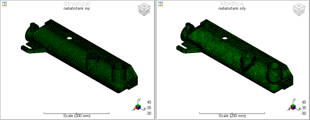

  1. With Advanced Material Exchange open, import the structural input file (Start & Learn > Launch > Import Structural Model).
  2. Locate the radiatortank.inp file and select units of Millimeters.
  3. Select the part from the assembly and click OK.
  4. Now import the Moldflow model (Home > Launch > Import Moldflow Model).
  5. Locate the radiatortank.sdy file and click OK.
