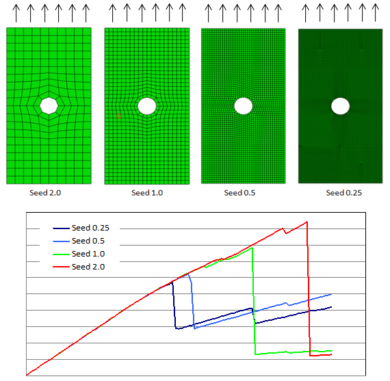

Typically, a larger element size will result in a higher predicted ultimate stress. This occurs because the integration points in larger elements are further away from the stress concentrations. As a result, the element is able to hold more load until failure occurs. In smaller elements, the integration points are closer to stress concentrations. As a result, they can fail earlier which results in a lower predicted ultimate stress. We can see an example of this effect in the image below.
Here we see an open-hole coupon model with four different mesh sizes. When we plot the load-displacement response of each model we can see how the difference in mesh size will influence the predicted ultimate load. Failure will propagate from the stress concentration at the hole more quickly when a small mesh size is used.
