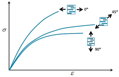

With the current model, good fits can be obtained by using three different tensile tests to failure. The image below shows such a collection of tensile tests and includes data from tensile loading at three different directions relative to the average fiber direction of a mostly-aligned material. The tensile tests include 0°, 45°, and 90° specimens. In each case, the specimen is loaded until final rupture occurs.
