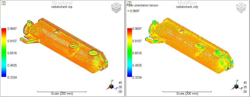

Now we are ready to map the fiber orientations to the structural model.
Click
Home
Mapping
Map Results
If not already visible, click
Home
View Results
Fiber Orientation
Rotate the model as necessary to examine the mapped results.
