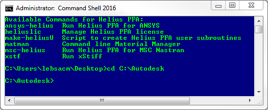

  1. Open the Helius PFA 2016 Command Shell by clicking the desktop icon (or Start > Autodesk > Autodesk Helius PFA 2016 > Command Shell 2016).
  2. Change the directory of the command prompt to the directory that contains the input file to be modified.
    >>cd < path of input file >
    Example:

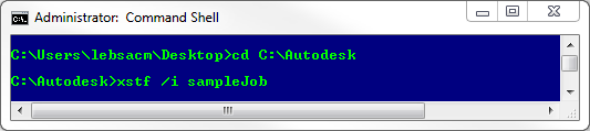

    >>cd C:\Autodesk
  3. Invoke xStiff.
    >>xstf /i < input filename >
    Note: Do not include the .inp extension.
    Example:
    >>xstf /i sampleJob
