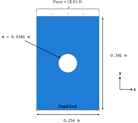

The problem consists of a flat composite plate with a hole in the center subject to fixed boundary conditions on one end, and a maximum load of 0.001 (N) on the other end. The plate is made of a unidirectional material. The layup is [0/±45/90]s, and the ply thickness is 0.000127 m which results in a plate thickness of 0.001016 m. The load ratio Smin/Smax is 0.1 and the frequency of loading is 10 Hz. The seed size for the mesh is 0.005 and eight noded isoparametric brick elements with reduced integration are used. The dimensions, boundary conditions, and load are shown below.
