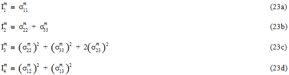

Using these four basic assumptions, researchers from the University of Wyoming and Autodesk have developed the following matrix failure criterion that is expressed as a quadratic function of the matrix average stress components.
In Eq. 22, the quantities (j = 1,2,3,4) are transversely isotropic invariants of the matrix average stress state.
The quantities (i = 1,2,3,4,5) are the adjustable coefficients of the matrix failure criteria. In Eq. 22, if a superscript symbol '±' precedes an adjustable coefficient , it indicates that the numerical value of depends on whether the associated matrix average stresses are tensile or compressive; hence represents two possible values. For the coefficient , there are actually four possible values depending on whether is positive or negative and also on whether is positive or negative. Therefore, the matrix failure criterion (Eq. 22) contains a total of 10 adjustable coefficients that must be determined using measured strengths of the composite material.
