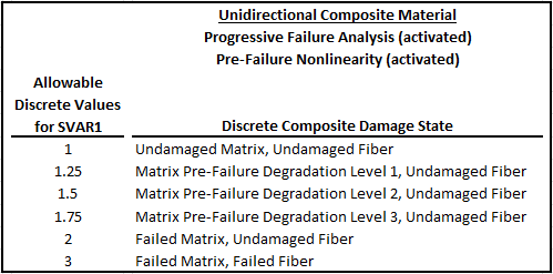

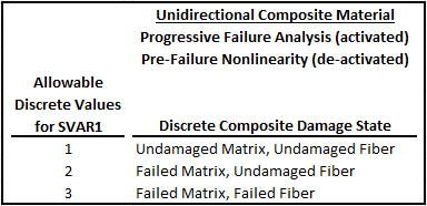

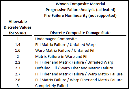

SVAR1 is an integer variable that represents the discrete damage state of the composite material. The range and interpretation of integer values assumed by SVAR1 depend upon the specific set of material nonlinearity features used in the analysis. The following tables provide the interpretation for each allowable integer value of SVAR1 for each possible combination of material nonlinearity features employed by Helius PFA.

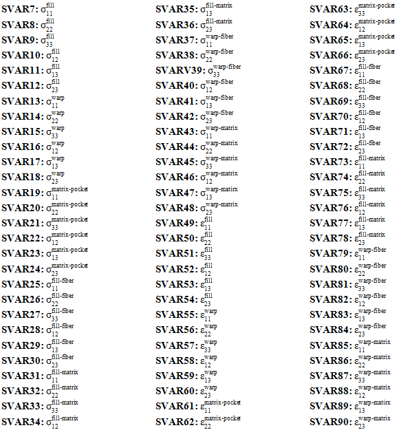

For the case of woven composites, the remaining MCT state variables store the individual components of the average stress and strain states in the various superconstituents and constituents (e.g., fill = fill tow superconstituent, warp = warp tow superconstituent, matrix-pocket = matrix constituent of the intertow matrix pockets, fill-matrix = the matrix constituent of the fill tow, warp-matrix = the matrix constituent of the warp tow, fill-fiber = the fiber constituent of the fill tow, warp-fiber = the fiber constituent of the warp tow).

For the case of a progressive fatigue analysis with woven materials, SVAR11 through SVAR94 are used to store the individual components of the average stress and strain states in the various superconstituents and constituents (equivalent to SVAR7 through SVAR90 for static analyses).
