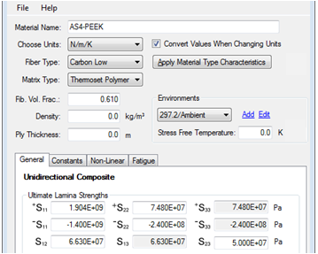

  1. To begin the optimization process, open Composite Material Manager and specify a unidirectional material (File > New > Unidirectional).
  2. Populate the GUI as shown below.

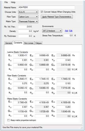

  3. Switch to the Constants tab within the GUI and enter the elastic constants as shown below.

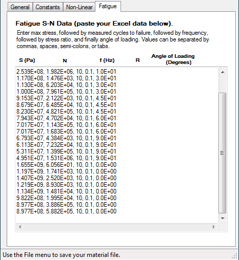

  4. Switch to the Fatigue tab within the GUI and enter the S-N data as shown below. You can copy and paste the values from the S-N tables provided earlier.
