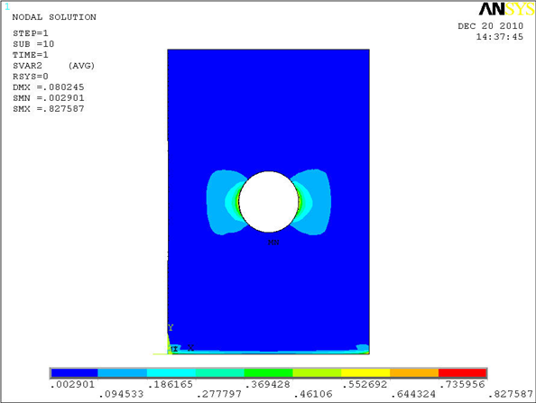

  4. To plot SVAR2 using a PLNSOL contour plot, enter PLNSOL,SVAR,2 into the command prompt. The default plot will plot the bottom section point of the bottom layer and the top section point of the top layer. The contour plot should be similar to the plot shown below. Minor differences are usually the result of mesh variations.
  5. Note the maximum value of SVAR2 in ply 1 is 0.83, which occurs on the bottom surface due to the boundary conditions. Ignoring the boundary condition stress concentration, the largest value of SVAR2 is approximately 0.55 and occurs at the notch stress concentration. Since the maximum value of SVAR2 near the notch is less than 1, matrix failure is not predicted to occur in ply 1.

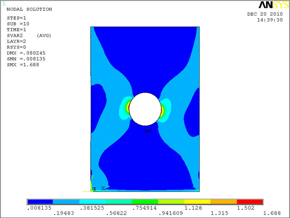

    To view results in a specific ply (or layer) of the composite plate, the LAYER command can be used.
  6. Enter LAYER,2 in the command prompt to view results in ply 2 (90 degree ply).
    Note: It may be necessary to click Utility Menu > Plot > Replot to refresh the Graphics Window. The results for ply 2 are shown below.
  7. In ply 2, the maximum value of SVAR2 is 1.69, which means that matrix failure is predicted to occur in ply 2. To determine when matrix failure is first predicted to occur, progress through the sets until SVAR2 is greater than 1. Commands to view results at specific points in time can be accessed from Main Menu > General Postproc > Read Results or using the SET command.
  8. Starting at Substep 1, progress through the step while refreshing the Graphics Window to determine when failure initiates in ply 2.
    • Enter the commands, SET,1,substep# or
    • Main Menu > General Postproc > Read Results > By Load Step.
    • The matrix failure criterion is satisfied at time = 0.8.
