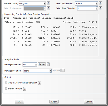

Select Plug-ins > Autodesk > Create Composite Material from the main toolbar.
From the Material Library list, select the material IM7_8552.
Note: The unit system dependent Engineering Constants specific to this material are listed in the dialog box for you to review.
Since this model uses inches and pounds as base units, select lb/in/R from the Select Model Units list. There are 4 unit systems to choose from. The default unit system is N/m/K.
Select 1 as the fiber direction.
2 can also be used as the fiber direction, but it would require a different composite layup orientation than the 1 direction. As a general rule, it is recommended that 1 be used as the fiber direction to maintain consistency from model to model. On occasion, however, it will not be possible to create an orientation in Abaqus that allows for the 1 direction to be the fiber direction due to the combination of complex model geometry and section orientation limitations. In such cases, it may be necessary to use the 2 direction as the fiber direction.
In the Damage Evolution menu, select None. With progressive failure deactivated, the stiffness of the elements remains unchanged throughout the analysis. In contrast, when Instantaneous or Energy-Based damage evolution routines are used, the stiffnesses of the elements are reduced after failure has been predicted by the failure criterion.
The plug-in should appear as shown below.
Click OK.
