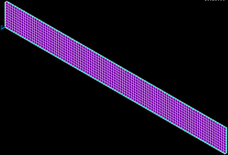

  2. Type CZMESH, , , 11, Z, 0.5 into the command window to create a layer of cohesive elements in the middle of our beam (z = 0.5 mm). The Graphics Window should appear as shown below.
The CZMESH command creates a layer of cohesive elements with zero thickness. These elements use the INTER 205 element defined earlier. The cohesive elements use the Helius PFA cohesive material defined with the Create Cohesive Material tool.
