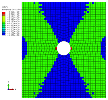

The default Contour Type is Banded, but the Quilt type is more useful for viewing SDV1 output. To switch from Banded to Quilt, select Options > Contour from the main toolbar, and select Quilt as the Contour Type. Click OK. The plot should be similar to that shown below. Minor differences are usually the result of mesh variations.

Note: the default ply for the contour plot shown above is Ply-1. To view failure in all of the plies, envelope plots can be used. Envelope plots display the maximum or minimum integration point value across all section points in each element.
Select Result > Section Points from the main toolbar to create an envelope plot. Select the Envelope option from the Categories box and click Apply. The plot should be similar to that shown below.

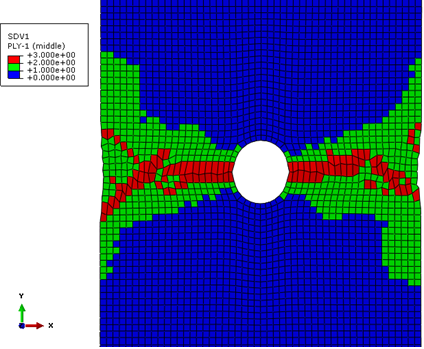

To view the failure state of a single ply, click Plies from the Section Points dialog box. View the failure in each ply. Note that plies with the same orientation have identical failure states since the laminate is symmetric. For example, Ply-2 and Ply-23 have the same failure states.

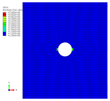

Starting at Step Time = 0.000, progress through the step while watching the viewport to determine when failure initiates and how failure propagates.
First matrix failure should occur at Step Time = 0.25 (First image below).

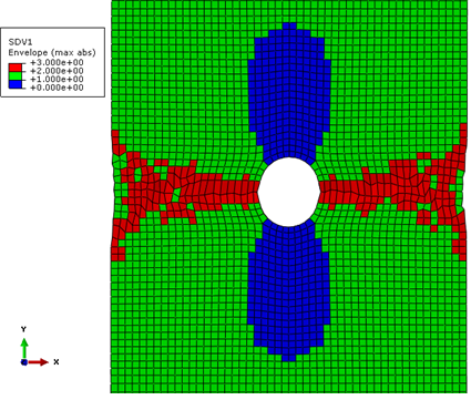

First fiber failure should occur at Step Time = 0.65 (Second image below).

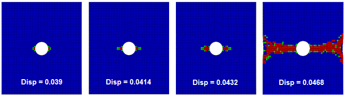

Next, consider the progression of failure in ply-2, which is one of the main load carrying (0°) plies. The plot below shows failure in ply-2 at several displacements. As expected, failure initiates at the corners of the notch and progresses laterally towards the edge of the plate until ultimate failure.
