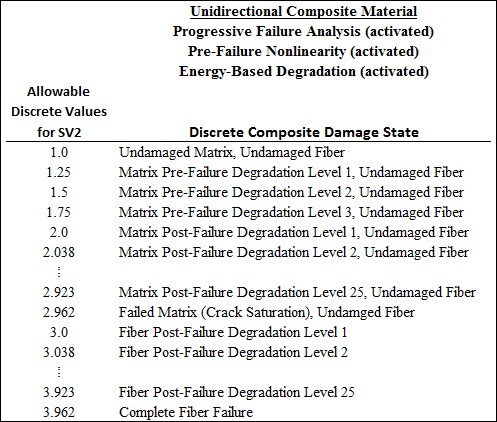

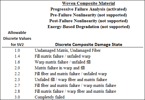

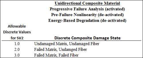

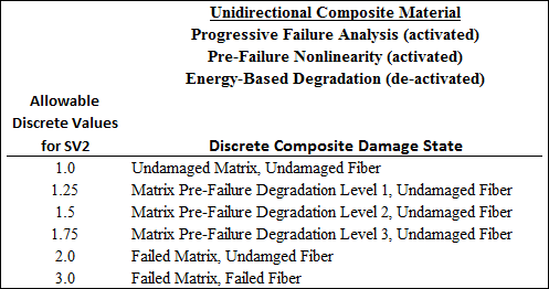

SV2 (often renamed as MAT_STATE) is a real variable that represents the discrete damage state of the composite material. It assumes a finite number of discrete values between 1 and 3. The number of discrete values assumed by SV2 and the interpretation of those discrete values depend upon the type of composite material (i.e. unidirectional or woven) and the specific set of material nonlinearity features employed to describe the material's response. The following tables provide the interpretation for each allowable discrete value of SV2 for each possible combination of composite material type and set of material nonlinearity features.
Unidirectional Composites - Static Analyses
For
unidirectional composite materials, state variables SV3, SV4, ..., SV36 have the following interpretations for static progressive failure analyses:

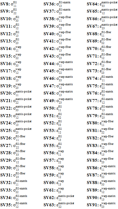

For the case of unidirectional composites, the remaining MCT state variables are used to store the individual components of the matrix average stress and strain states and the fiber average stress and strain states.

Woven Composites - Static Analyses
For
woven composite materials, state variables SV3, SV4, ..., SV91 have the following interpretations for static progressive failure analyses:

For the case of woven composites, the remaining MCT state variables are used to store the individual components of the average stress and strain states in the various superconstituents and constituents (e.g., fill = fill tow superconstituent, warp = warp tow superconstituent, matrix-pocket = matrix constituent of the intertow matrix pockets, fill-matrix = the matrix constituent of the fill tow, warp-matrix = the matrix constituent of the warp tow, fill-fiber = the fiber constituent of the fill tow, warp-fiber = the fiber constituent of the warp tow).
