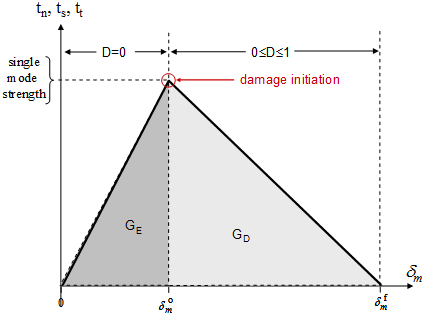

In the graphic above, denotes the value of the effective relative displacement at damage initiation, e.g., at the time when
becomes satisfied. denotes the value of the effective relative displacement at which the material stiffness has fully degraded to zero. denotes the maximum value of the effective relative displacement that has been attained by the material to date for any time t less than or equal to the current time. Note that and are considered to be part of the material characterization.
