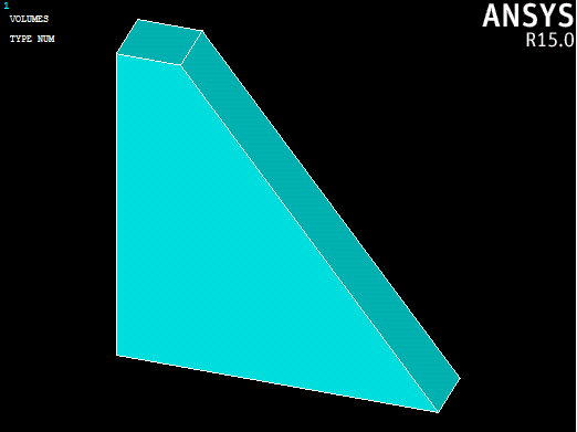

  4. First we will create the geometry for the rubber pad used to distribute the load on the top of the beam. Keypoints will be used to create the volume in units of millimeters.
  5. Click Main Menu > Preprocessor > Modeling > Create > Keypoints > In Active CS.
  6. In the dialog that appears, number the first keypoint 1, with coordinates (2.5, 2.1, 0.0) and click Apply.
  7. Repeat this procedure for the remaining seven keypoints:
    • 2, (2.5, 2.1, 0.5)
    • 3, (0.0, 2.1, 0.5)
    • 4, (0.0, 2.1, 0.0)
    • 5, (0.5, 4.725, 0.0)
    • 6, (0.5, 4.725, 0.5)
    • 7, (0.0, 4.725, 0.5)
    • 8, (0.0, 4.725, 0.0)
    Click OK.
  8. Now create the volume by clicking Main Menu > Preprocessor > Modeling > Create > Volumes > Arbitrary > Through KPs.
  9. In the dialog that appears, type 1, 2, 3, 4, 5, 6, 7, 8 and click OK. The sequence of selecting keypoints is important to create the proper volume.

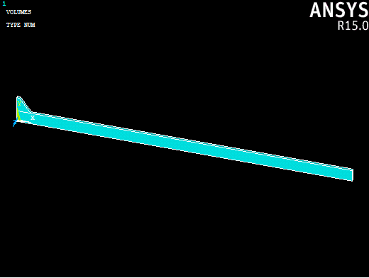

  10. As a last step, we can create the geometry of the beam.
  11. Click Main Menu > Preprocessor > Modeling > Create > Volumes > Block > By Dimensions.
  12. In the dialog that appears, enter the following values and click OK.
    • X1, X2 = 0, 60
    • Y1, Y2 = 0, 2.1
    • Z1, Z2 = 0, 0.5
