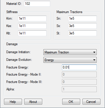

In the following steps, a user-material is defined using the Create Cohesive Material plug-in.
  1. Click the HELIUS button and click Create Cohesive Material in the dialog that appears.
  2. Give the cohesive material an ID of 102.
  3. Enter 1.0E+11 for Knn, Kss, and Ktt, 1.0E+05 for Sn, and 3.0E+05 for Ss and St.
  4. Select the Maximum Traction Initiation Criterion and Energy Softening Type
  5. Enter a Fracture Energy of 0.01.
  6. The dialog should now appear as shown below. Click OK to create the material.
