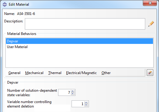

The DELETE=1 parameter can be added using Abaqus/CAE or by manually editing the input file with a text editor. With Abaqus/CAE:
  1. Switch to the Property module
  2. Click Material > Edit > NameOfMaterial
  3. Select Depvar from the list of Material Behaviors
  4. Set the Variable number controlling element deletion to 1
  5. Click OK

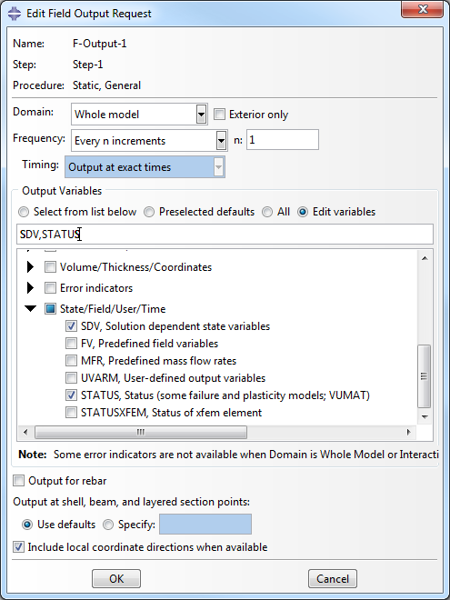

The STATUS variable can be added to the output requests with Abaqus/CAE or by manually editing the input file with a text editor. With Abaqus/CAE:
  1. Click Output > Field Output Requests > Manager
  2. Click Edit
  3. Select STATUS from the list of output variables
  4. Click OK
Note: If this step is omitted, element deletion will still work properly. However, Abaqus/Viewer will not remove the deleted elements from the visualization.
