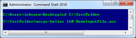

This file is located at HPFADIR\bin\ansys-helius.bat and can be modified using a text editor to meet your specific needs. To run this file, follow these steps (see the image below) :
  1. Save the ANSYS input file with a .ans extension
  2. Open the Helius PFA Command Shell using the desktop or start menu shortcut.
  3. Change the directory to the directory which holds the file saved in step 1
  4. Run the job using the following command
    ansys-helius VERSION FILE
    where VERSION is one of 145, 150, 160, 161, or 162 depending on the target ANSYS version and FILE is the name of the input file saved in step 1.
