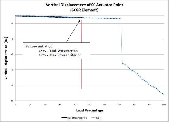

The table below shows the load level at which each type of failure event is predicted using the three different failure criteria. The plot that follows displays the load-vertical displacement curves for the load application point at 0°.
Note: The max-stress and Tsai-Wu failure criteria only provide information on failure initiation for the homogenized composite material, hence these criteria predict that matrix failure and fiber failure both initiate at the same load level (43-45%). The MCT criteria predicts that the matrix constituent failure initiates at a load of 42% and fiber constituent failure initiates at a load of 62%.

  2. Global failure is defined as a large discontinuity in the load-vertical displacement curve for the 0° application point of the load head shown previously
  3. Global failure is unable to be determined, see text for details
  4. Composite laminate failure
The plot below displays the load-displacement curves for the load application point at 0°. Before global failure is achieved (72%), both methods produce similar predictions for overall structural stiffness. In using the linear elastic material failure criteria available in Abaqus, material stiffness degradation is not accounted for. Therefore, the failure analysis can only proceed up to the point where localized failure initiation is predicted. The capability of Helius PFA to degrade material stiffness at integration points that have failed (either matrix of fiber failure) lends the unique capability of accurately capturing the progression of local failure initiation into eventual global failure. An important concept to note is that the composite structure retains most of its structural stiffness well past the initiation of local failure. Designs where failure is predicted using first-ply failure are often grossly conservative and the full capabilities of the composite structure will not be recognized. Along with this, you can accurately describe the post-fail behavior of the structure with Helius PFA, something that is not available with the Abaqus failure criteria.
