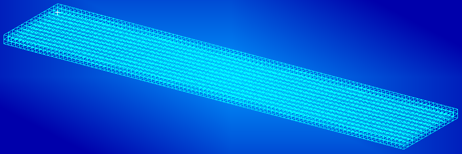

  3. Click File > Import and navigate to the location of Tutorial_4_Nastran.bdf. Make sure the Source is set to MSC.Nastran Input.
    Note: The bulk data file Tutorial_4_Nastran.bdf can be downloaded here.
  4. Click Apply to import the mesh. The beam should appear as shown below.
